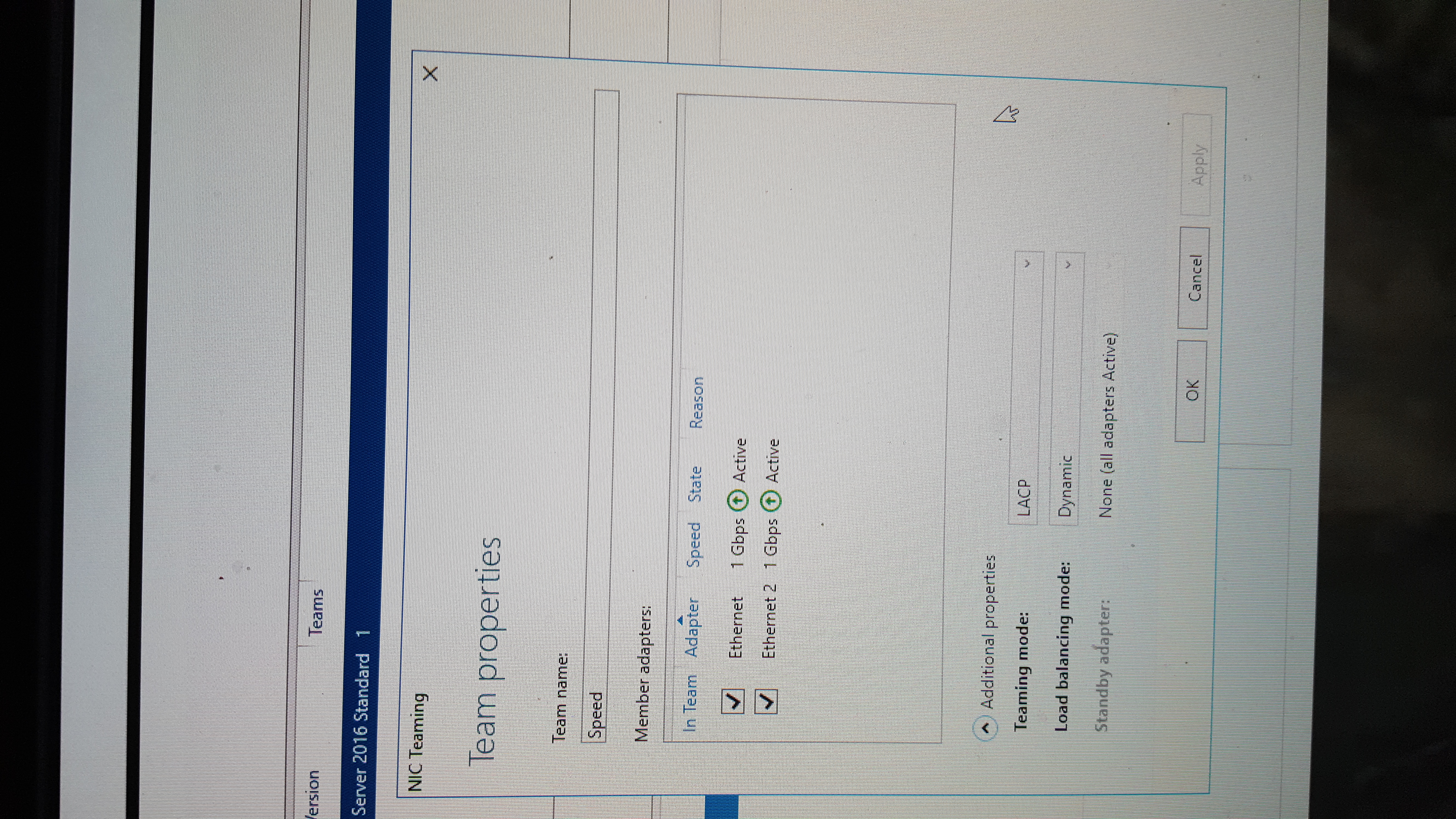

here are the pics of the server

Packets belonging to the same stream (flow) will always use the same switch port in an etherchannel - traffic distribution among members of an etherchannel can be done based on source/destination mac address, source/destination ip address, sometimes source/destination tcp/udp port...  but as long as the parameters of the chosen hashing algorithm don't change, neither does the port used to send the traffic.
If you only have one source and one destination across an etherchannel on a 3750 (which can only hash based on mac or ip), bonding ports is pretty much useless...
