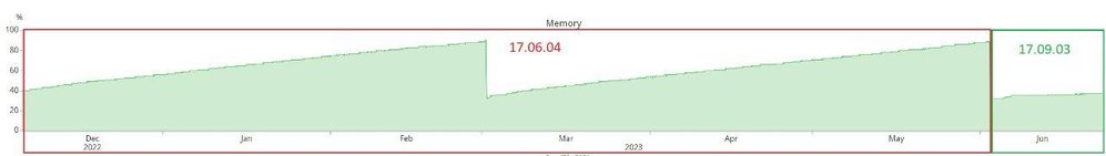

Have a look at the picture below.
6 x 93006 x 9300
Could you tell me what the picture is showing and what issue I am hitting?
I have a stack of 9300 and the stack is made up of six (6) 9300.  The picture is the control-plane memory utilization of a single switch, the switch master.
IOS-XE is very buggy and memory is just one of them.  The picture shows that when the stack was on 17.6.4, the memory leak was extremely severe that I had to reboot the stack every 3 to 4 months.  After upgrading to 17.9.3, the memory leak still occurs but the rate is not that severe.
