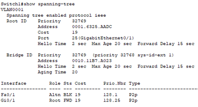

When a tiebreaker comes down to port number, it's not actually the port number itself (Fa0/17 or Gi0/17). Each port has a number you can see with the command show spanning-tree. It's the number after the dot in the Prio.Nbr column. This is what is used during a tiebreaker.
Here is the output of show spanning-tree on Switch1 in the above configuration:
Gi0/1 is elected as the root port because its cost is lower.
However, if we manually set the spanning-tree cost of Gi0/1 and Gi0/2 to 19, so all ports have the same cost...we see Fa0/1 wins.
However...Fa0/1 doesn't win because its port number is the lowest. It wins because its neighbor's port number is the lowest. In the previous image, Fa0/1 was plugged into the neighbor switch's Fa0/1 port, Gi0/1 into Gi0/1 as well. Now if we switch the connections so Fa0/1 is plugged into Fa0/3 and Gi0/1 is plugged into Fa0/2:
We can see Gi0/1 becomes the root port again because its neighbor's port number is lower.
