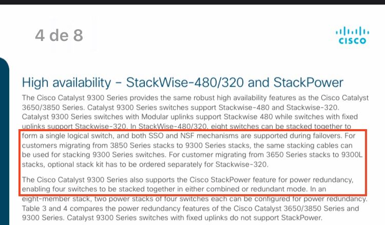

Can I use the same power supplies, network modules, powerstack and data stacking cables between the 9300 series and the 3850 series??   Thanks
