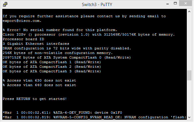

hello guys ...
i have a problem ..when i reload the switch vIOS-L2 after tapping the command
#copy startup-config running-config
i get these msg
thanks

THIS IS THE STARTUP CONFIG
AND THIS THE RUNNING CONFIG
SO WHEN I RELOAD THE SWITCH I ALWAYS I SHOULD TAP #COpy startup-config running-config
TO GET MY OLD CONFIG AND WHEN I FINICH I TAP #COpy running-config startup-config
