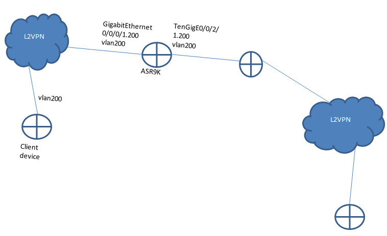

Need help for below please.
Below is the kind of topology I have, and I want to connect behind L2VPN network. with the configuration I did, I can see traffic in on the physical interface(0/0/0/1) connected to the L2VPN network but no traffic out and no traffic on both sub-interfaces also. Please can anyone help me with right configuration may I perform on my Cisco ASR9K router to make service working.
see configuration on the ASR interfaces:
"interface TenGigE0/0/2/1.200 l2transport
encapsulation dot1q 200
interface GigabitEthernet0/0/0/1.200 l2transport
Thanks in advance for your kindly support.
Regards.
2 Replies 2
ASR local connect need this,
Thanks for your reply, so you mean the configuration I did on my subinterfaces are OK but I have to add attached configuration ou sent?
