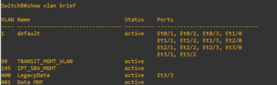

In SW-b
Show vlan do you see the vlan ?
If not you need to add it by
Vlan x
sorry you already  have EIGRP between two SW no need static route
Still no ping
eigrp stub connected summary
remove this and check
did not help
Do traceroute see where traffic stop in SW a or SW b
Share here
I review the show vlan you share
VLAN911 is not appear in SW-B ??

All the L2 vlans are there, I just did not post whole cfg.
