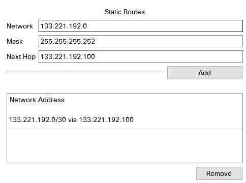

Thank you for your response Paul, I appreciate it.
I was told to stay away from the CLI for now but I think I get it.
So if I wanted PC1 from subnet A to communicate with PC2 from subnet B from subnet A router my static route would look like this
