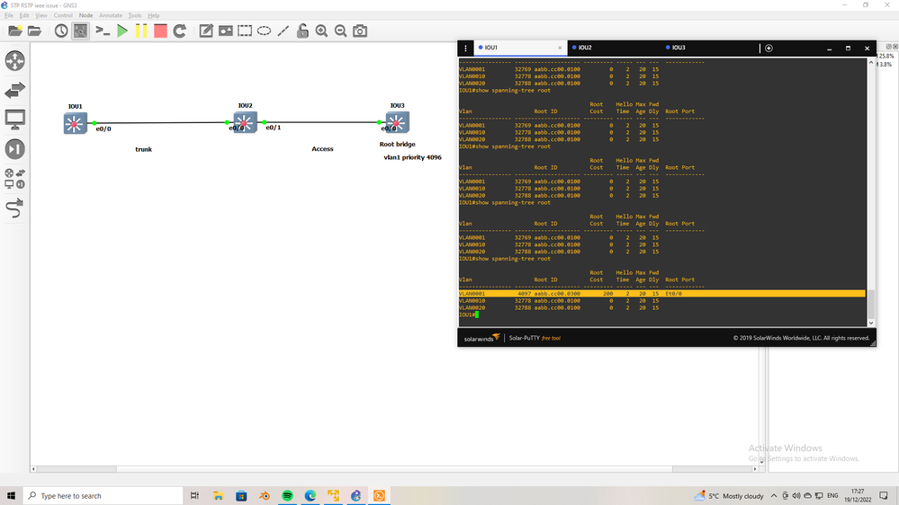

I inform you before to check the VLAN and allow vlan in trunk in the way to root bridge,
anyway
this lab give me exact same issue you have
VLAN1 show interface to root bridge
other vlan don show interface!!!
Yes, how I get this reuslt ?
from IOU1 to IOU2 there is trunk and vlan allowed in this trunk BUT from IOU2 to IOU3 (root) there is access assign to vlan 1.
here
IOU1  not receive any BPDU about other vlan only VLAN1 from root bridge and hence you can see that IOU1 elect interface and IOU3 as root bridge
but what about other VLAN ?
other VLAN since IOU1 not recieve BPDU it declare that it is the Root and hence you dont see root interface.
you issue is vlan missing in one SW OR not allow in trunk and hence there is no BPDU.
