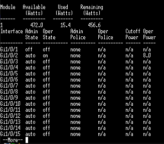

Post the complete output to the command "sh power inline".  I suspect the 48-port switch is powered by a 750wac power supply that is originally meant for a 48-port non-PoE or a 24-port PoE switch.

Thanks, solved issue by using 2 PSU 715 X 2 now total poe available 1187 Watt.
