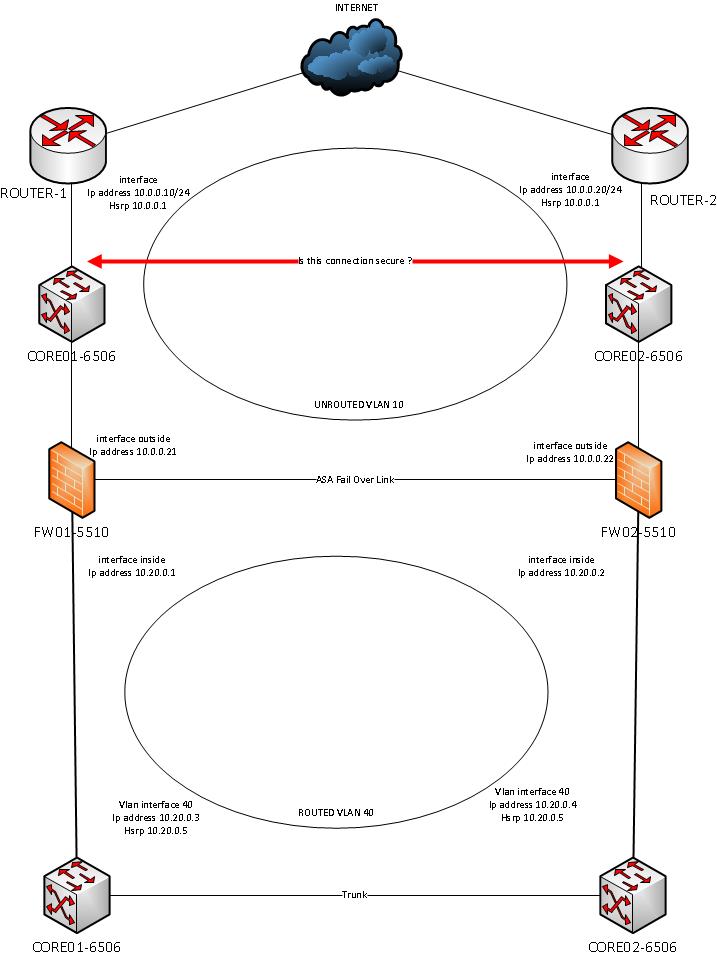

We have 2 6506's connected through an ether-channel trunk.
On these 6506's we have configured a vlan, vlan interface and 2 access ports for 2 ASA's.
These ASA's run in failover mode but only one ASA is physically connected at the moment.
We want to be more resilient so our provider has provided us with a redundant setup of routers for our internet connection.
However, for this construction they would need a layer 2 connection on our side to have HSRP running.
There are 2 options in my opinion :
- Buy a set of switches to facilitate the layer-2 connection between te routers and to connect the outside of the ASA's.
- Instead of buying 2 new switches, create a new unrouted vlan on our core 6506's and use access-ports for the routers and the ASA's.
But how safe is it to connected the core switch with an unrouted vlan to the internet router ?
In terms of vlan hopping or other possible attacks ?
I think i have to disable DTP, Spanning-Tree, CDP and maybe a lot more ?

I don't think that is an issue.  You have 2 border routers that face the provider's routers, which is a common setup.  You also have firewalls behind your core routers to protect the internals network.
HTH
If the router and ASA interfaces are all access ports then DTP and VLAN hopping wouldn't be a factor on those interfaces. Then the only place it could happen is in the trunk between the 6506's. That you can mitigate by preventing native (untagged) packets being sent on that link in either direction.

You don't need to buy a set of switches.  You just need a trunk port between core1 and core-2 6500 switches.  Then create 2 /29 subnets, one connects the 6500 core switches to the border router-1 and 2 with HSRP or VRRP and the other /29 connects the 6500 core switches to the firewall with VRRP or HSRP.
HTH

My main concern is security of the layer-2 port when connected to the router.
Any opinion about that ?
HTH
And what about vlan hopping ? Because the 6506 between the router and firewall and the 6506 behind the firewall are the same devices.
I am as far as applying this to secure the port :
switchport
switchport mode access
switchport access vlan X
switchport nonegotiate
spanning-tree bpdufilter enable
spanning-tree portfast edge
switchport port-security
switchport port-security maximum 3
switchport port-security violation restrict
no cdp enable
Any additions to this ?
