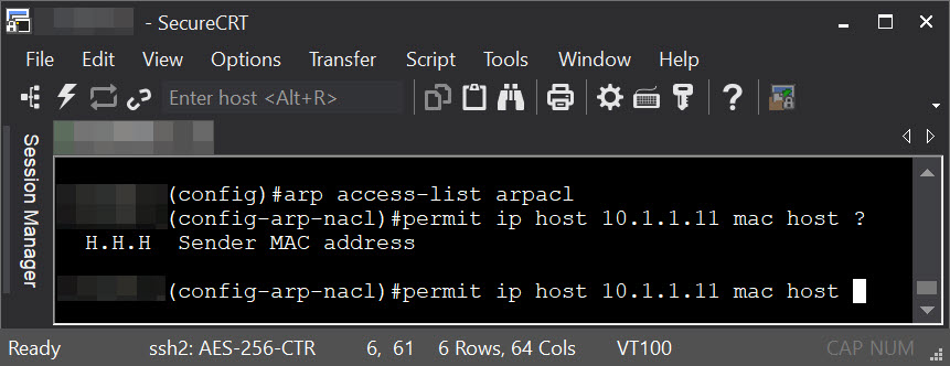

Studying for CCNP 300-115 and during my review I was exploring the options for dynamic arp inspection. I'm curious about the difference between "Sender MAC address" and "Single Sender host"....I can only spend so much time on Google so this seems to be a more effective way to get answers.
SWITCH-B(config-arp-nacl)#permit ip host 10.10.20.20 mac ?
  H.H.H  Sender MAC address
  any    Any MAC address
  host   Single Sender host

can you copy the output from the following?
"permit ip host 10.10.20.20 mac host ?"
I'm guessing the host command is not necessary and is there for backward compatibility.
I stand corrected.  You can create a mask for the MAC address implying multiple hosts.
