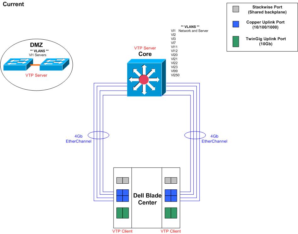

Currently in our data center, we have a Cisco 6513 as the core ,a single Dell m1000e blade center containing a pair of Cisco 3130G switches, and a pair of Cat 3550 switches for the DMZ (plus a load of other stuff not needing to be mentioned here). The 6513 and the DMZ 3550 switches are separated by a PIX firewall. The blade center 3130G switches are trunked back to the 6513 via a 4Gb etherchannel using the copper ports. The 6513 is the VTP server and the 3130G switches are VTP clients in the same domain. The Cat 3550 switches in the DMZ are VTP servers for the DMZ domain (see "Blade Center Switch-Current.jpg" for topology).

1- I was thinking of connecting the new Dell m1000e blade center chassis to the current Dell m1000e blade center via stackwise cables for better throughput and less of a possibility for spanning-tree considerations. Does this sound like the best approach?
2- As far having some ports/blades to be available for the DMZ as well as the internal network, is it possible to make a trunk from the DMZ to one or two of the 3130G switches and not compromise security?
3- Since the DMZ servers are the VTP servers for the DMZ domain and the 6513 is the VTP server for the internal network, what is a good way to deal with that? Do I need to make the 3550 and/or the 3130G switches VTP transparent?
Thanks for the advice in advance.
Pete

1) Not familiar with the Dell blades so not sure i can help much with their connectivity to the core. What strikes me from your proposed diagram is that if the 4Gb etherchannel from the right-hand blade centre fails then you have lost all servers to the core. Perhaps a second etherchannel from the left-hand blade centre to the core ? You could load-balance the vlans by using 1 of the 4gb etherchannels for odd vlans and 1 for evens by manipulating the STP root/secondary. But like i say not really familiar with Dell's.

I was thinking about another etherchannel back to the core in case the 1st one fails. I figured it may cause some spanning-tree concerns but I'm now see that it's better to address STP as compared to having the single point of failure.
As far as the VTP transparent config... I should be doing that on the DMZ switches in addition to the blade center switches? I was thinking I need to keep the blade center switches as VTP clients but not positive.
It doesn't help too that we've got VLAN 1 as a main vlan for production servers/network devices in both the 6513 AND the DMZ! A nagging issue rearing it's head here I feel. I'm thinking I need to address that as well so there is no confusion as to what gets trunked where. I'm thinking I need to change the DMZ to something like VLAN 100 and then just trunk that vlan down to the blade center switches but not positive.

As mentioned get rid of vlan 1. However if the DMZ only contains 1 vlan and you are happy to manage the switch with an IP from that vlan then you don't need a trunk back to the blade switches and if you don't need a trunk VTP is not an issue. You can simply make the connection an access port connection in the DMZ vlan.
If you do need multiple vlans from the DMZ then yes you will need a trunk but again avoid vlan 1 for either data or management.
