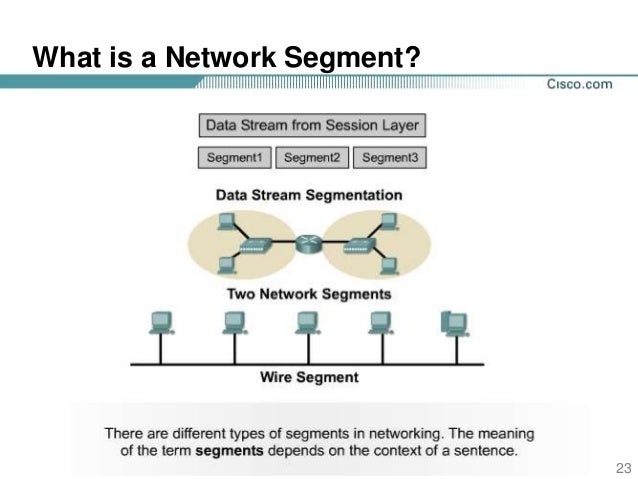

You are welcome, the term network segment can be ambiguos, but basically it is a connection between switches:
Image result for layer 2 network segment
As it says, it depends of the context but you could have the root bridge for all the VLANs on one network segment, in few words the root bridge is configured on one switch for all the VLANs.
