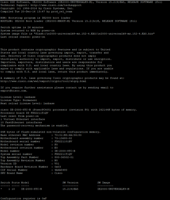

I got. Can you run the command  "show version" and "show license" and share the output?
This is the sh ver
This is the sh license
As per the show version, the license running on this switch is lanbase and as per the cisco docs, to run EEM you need IP Base or IP services
