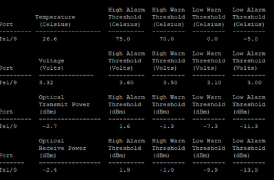

I do have a patch panel in between. I've already tried replacing the fiber and SFP which connects the switch to the patch panel, but it does not resolve the issue. On the 2960S I also have low Optical Receive Power, however this problem is not present on the core switch.

if the length is more we see power optic low and 0 (N/A) and this what I see from show controller
MHM
But wouldn't I see low optical receive power in the core switch too? It should be a 2 way thing right, since both the core and the 2960 are sending and receiving data.
This is from the core 4500X
