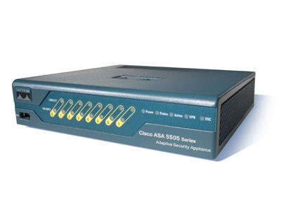

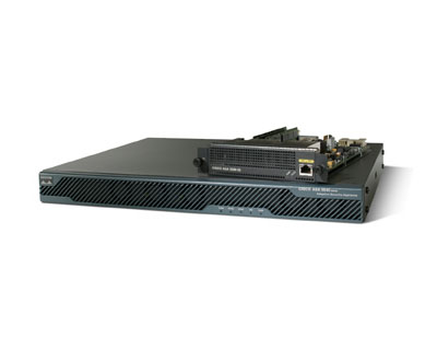

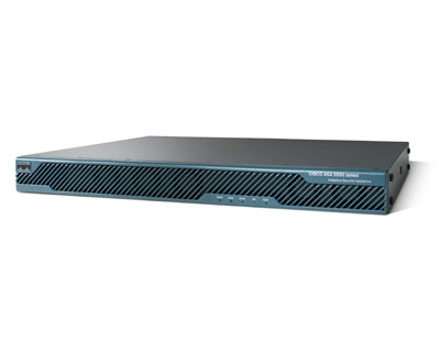

I’ve just discussed about this matter with my friend and he said “input rate” is enough to determine the bandwidth used in the network. So, obviously Cisco ASA 5505 is just nice as it can support up to 150 Mbps throughput while the throughput on the network just 3000 bits/sec. Is that true?
Cisco ASA 5500 Series Model/LicenseCisco ASA 5505 Base /
Security Plus
Cisco ASA 5510 Base /
Security Plus
Cisco ASA 5520Cisco ASA 5540Cisco ASA 5550
Product Image
(click to enlarge)
Network LocationSmall Business, Branch Office, Enterprise TeleworkerInternet EdgeInternet EdgeInternet EdgeInternet Edge, Campus
Performance Summary
Maximum Firewall throughput150 Mbps300 Mbps450 Mbps650 Mbps1.2 Gbps
http://www.cisco.com/en/US/products/ps6120/prod_models_comparison.html#~mid-range
