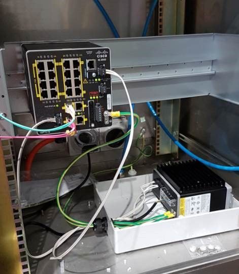

Hello Stephen,
I'm suspecting that the issue is more related to how the Power Supply is connected to the IE-2000.
  • What's the part number of the power supply that you're using?
  • How is the power supply connected to the switch?
Be aware of the following:
The IE 2000 switch models with PoE capability (IE-2000-16PTC-G-E, IE-2000-16PTC-G-L, and IE-2000-16PTC-G-NX) are equipped with an additional DC input terminal block. This DC terminal block allows the connection of a second power supply (see Power over Ethernet Ports), or a second input from site source DC power to operate the PoE ports. The PoE terminal block accepts 48 VDC or 54 VDC at 2.5 A.
The 170W (both AC and DC) power supplies have enough power for the base unit and the PoE. Connect one power output from the 170W PSU to the main power input of the IE2000, and the other power output of the 170W PSU to the PoE power input of the IE2000.
Regarding the 65W power supplies, those supports up to 4 ports PoE or 2 ports PoE+ when used in PoE power input in an AC or high DC environment.
The other thing would be to test (using a tester) that the power supply is in fact providing the expected power output.
Regards,
IE2000 with 170W power supplyIE2000 with 170W power supply
Thanks again for replying, I appreciate your help. As you can see, the connection is as documented. The measurement shouldn't be necessary - the situation is the same for nine switches.
