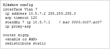

If R2 didn't support the "ip mobile arp" command (e.g., you've got Catalyst 3K/9K or Nexus 5K/9K), you can still use static host routes. Change the base config to:
and each time a host moves, add a static host route:
R2(config)#ip route 172.16.3.77 255.255.255.255 Vlan7 name host2
This form of static route has no next-hop IP, which causes R2 to ARP directly for that IP on that interface. This is a manual way of creating the same host route that "ip mobile arp" would have added dynamically.
When used for a one-way DC move, R2 Vlan7's 10.5.7.0/24 would be a dummy subnet with no actual 10.5.7.x hosts like host3. Once all servers are migrated to R2, you can shut down R1 Vlan 3 and move the 172.16.3.0/24 over to R2 Vlan7 IP/HSRP. Then, get rid of "ip proxy-arp" and remove the static routes if you have them.
