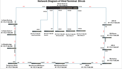

this is my network ring topology and all switches connected on camera and PC
i have not found this issue
all switches mac flapping error
STP working, but there are two switches different vlan, two port alternate and blocking port
