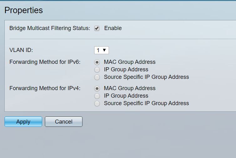

Testing shows that hosts in 192.168.10.64/26 range don't have access to LAN resources, except the multicast data broadcasted from 192.168.10.30 ! So, it seems that the above ACL rules are not blocking Multicast !

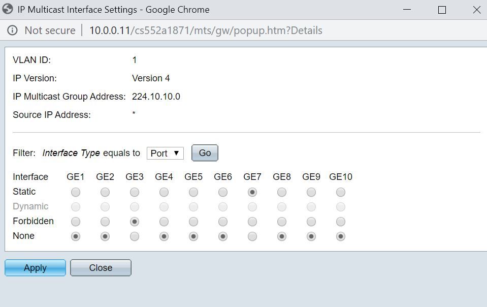

I went in multicasting and enabled the below setup in screenshots:
Broadcasting is done from port 7, guest/client network is connected from port 3.
Despite this, any client connected on port 3 and within the 192.168.10.64/26 range can access the broadcasting.
Putting GE7 on "None" doesn't prevent broadcasting to all the network.
Enabling IGM snooping status and querier doesn't change the scenario.
Am I doing it wrong or the Multicast filtering is broken in SG350 switch ?
