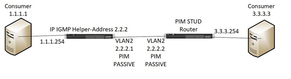

I have a Nexus 93108TC-EX with software version 7.0(3)I7(5) and Essentials license installed. I notice with this software in interface configuration mode, the command "ip igmp helper-address" doesn't exist. This Nexus switch replaced a 3650 switch that was configured to forward all IGMP traffic out a different interface to a device managing all IGMP traffic. So for example, a host from VLAN 1 (with IP address 1.1.1.1) sends a IGMP report, on interface VLAN 1 of the 3650 I have the command "ip igmp-helper address 2.2.2.2" so that when interface VLAN 1 receives the report, the IGMP is forwarded out VLAN 2 on the port where the host 2.2.2.2 resides. I want to be able to forward all IGMP traffic from one VLAN interface out a different VLAN interface. Is this possible with the Nexus 93108TC-EX switch?

The above is what I'm trying to achieve. The router that the Nexus connects to doesn't have PIM enabled so I have to be able to pass the IGMP traffic from VLAN 1 (1.1.1.254) to 2.2.2.2.
Sorry, the right side is the producer but this doesn't really matter. Just trying to pass the IGMP traffic.
