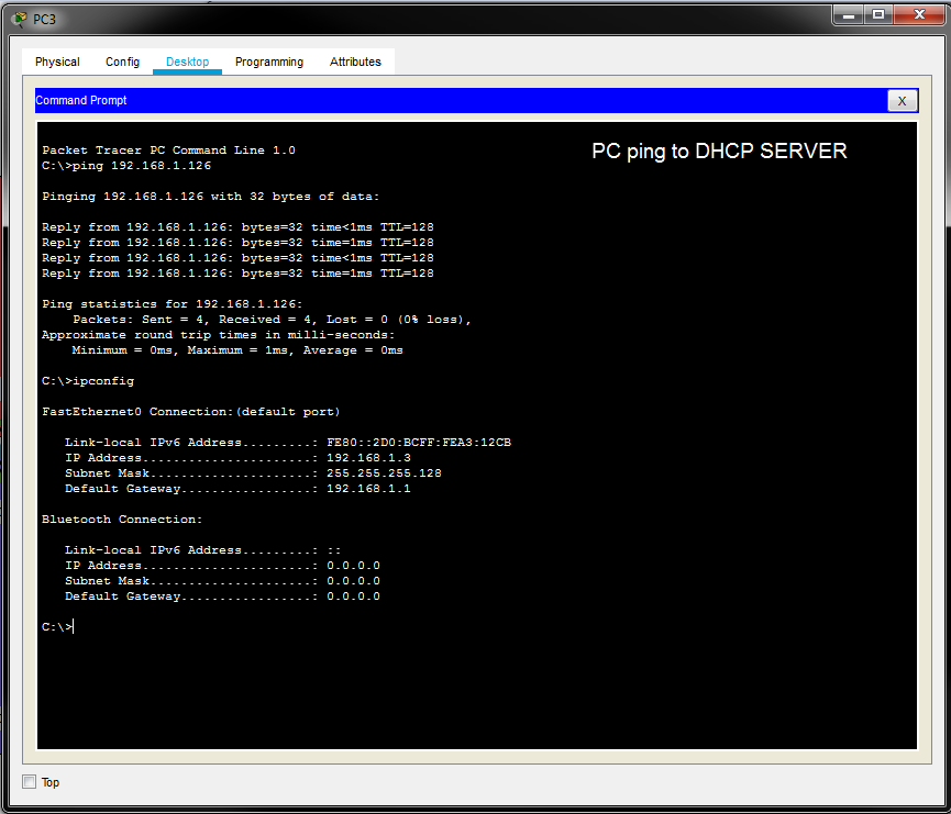

Just to clarify, the VLAN1 hosts can ping the DHCP server? But not the other way around?
Can you share the ipconfig output from a VLAN1 host and the DHCP server?
Can you share the config from the router?
Correct, the VLAN1 hosts can ping the DHCP server but not the other way around:
PC to DHCP server
DHCP to VLAN1, then to Host
