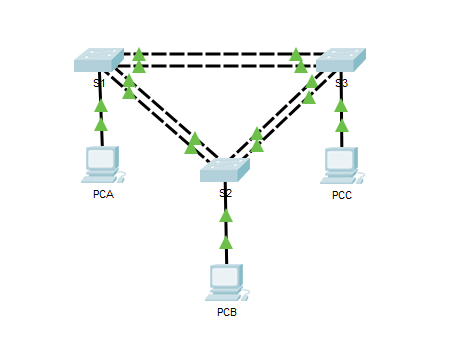

Hello all,
I've done everything I can think off and I just can't get this material. I cannot for the life of me ping pc to another pc using vlans.
If anyone can help me understand it better, it will be very much appreciated. I attached the packet tracer diagram and below are my 'show running-config'.

15 Replies 15
balaji.bandi
You should have Layer3 interface in one of the switch to take care of Routing and available gateway for PC-A / B -C
Enable
ip routing
craete VLAN Interface ( one of the switch) make sure you allocated respective VLAN where PC connected
example : PC-A belong to VLAN 10
example : PC-B belong to VLAN 20
example : PC-C belong to VLAN 30
nterface FastEthernet0/6
switchport access vlan 10
switchport mode access
spanning-tree portfast
nterface FastEthernet0/7
switchport access vlan 20
nterface FastEthernet0/8
switchport access vlan 30
interface Vlan10
ip address 172.27.10.1 255.255.255.0
interface Vlan20
ip address 172.27.20.1 255.255.255.0
interface Vlan30
ip address 172.27.30.1 255.255.255.0
BB
thank you for your reply. I added the gateway to the switches and still no connectivity?
You can attach PT file but it must be a zip format; so zip it, attach it, we can figure it out.
In the past, sometimes my PT got "Stuck".  Save it, close it, re-open your PT  file and then tested it
Hey sorry for the late reply, but I had to hold off on this project. Now I am back to square one and would appreciate the help.
Sorry but I don't see anywhere, where I can attach the PT file?
At the bottom of your 'Reply' post there is an option to drag and drop or browse files to attach. Make sure the Packet Tracer project (.pkt) file is zipped (.zip).
Thank you all for your replies. I'm not sure what I'm doing wrong so any help would be much appreciated.
balaji.bandi
The VLAN interface configuration required only on 1 switch not on all switches ?
Post all the switches configuration after modify the config.
give information where the PC connected what port in each switch ?
Let us know below tests ;
From PC-A / PC- B / PC-C  are you able to ping respected gateways ? Gateway IP that is .1 ? all VLAN ?
BB

yes, there is connection between the their respected gateways.
no connection between other vlan gateways.
Have you actually created the vlans on the switches
On a VTP server switch or on then all if in vtp transparent mode
something like
vlan 10
name PCs-Vlan10
vlan 20
name PCs-Vlan20
vlan 30
name PCs-Vlan30
vlan 90
name NATIVE-VLAN
Regards, Alex. Please rate useful posts.
Yes I have, and same results, no connectivity.
Martin L
as BB mentioned in his post; you need L3 switch; Although PT's 2960 (l2 switch) can handle routing, L3 switch like c3560 or c3650 can do better job and look better.
To communicate within same vlan (same subnet), you do not need routing enabled;
To communicate between vlans and different subents, you need either L3 switch using SVIs or Router-on-a-stick (ROAS) or plain router with several links to switch.

Okay, I'm not too familiar with the switches, but are you implying that I delete those 2960 switches and replace them with the L3 switches?
Hello
What you show are just the access layer switches and the end hosts what you dont show is the L3 device that would be responsible for the inter-vlan routing, This device will have the L3 interfaces of the default-gateways that the hosts are using, the switches you show should be running as host switches meaning no ip routing enabled
Post the PT file or the running config of the L3 device in this network
