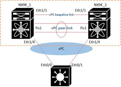

I currently test vPC on the base of lab. The vPC status shows it as "down" from the output of command "show vpc" and the status of etherchannel from L3 switch connecting to the vPC link shows it as (w).
Any points or tickets for this issue?
The followings are the diagram of the lab and outputs from commands of Nexus switches and L3 switches.
vPC test.jpgsd

channel-group 1 mode active
interface Ethernet1/4
switchport mode trunk
channel-group 2 mode active
interface Ethernet1/5
interface Ethernet1/6
interface Ethernet1/7
interface Ethernet1/8
interface Ethernet1/9
interface mgmt0
vrf member management
line console
line vty
boot nxos bootflash:/nxos.7.0.3.I5.1.bin
Switch#show run
Building configuration...
Current configuration : 1018 bytes
! Last configuration change at 01:14:37 EET Fri Nov 3 2017
version 15.1
service compress-config
hostname Switch
boot-start-marker
boot-end-marker
no aaa new-model
clock timezone EET 2 0
ip cef
no ipv6 cef
ipv6 multicast rpf use-bgp
spanning-tree mode pvst
vlan internal allocation policy ascending
interface Port-channel2
switchport
switchport trunk encapsulation dot1q
interface Ethernet0/0
interface Ethernet0/1
interface Ethernet0/2
duplex auto
interface Ethernet0/3
duplex auto
no ip http server
control-plane
line con 0
logging synchronous
line aux 0
line vty 0 4
login
end
Can you test using the global routing table for the vpc peering and the interface(no vrf)?
It appears the keep-alive with VRF is fine as the following command output. Is there any thing to cause this problem regarding VRF?
NX9K_1# show vpc peer-keepalive
vPC keep-alive status : peer is alive
--Peer is alive for : (10363) seconds, (372) msec
--Send status : Success
--Last send at : 2017.11.03 02:01:24 864 ms
--Sent on interface : Eth1/1
--Receive status : Success
--Last receive at : 2017.11.03 02:01:24 867 ms
--Received on interface : Eth1/1
--Last update from peer : (0) seconds, (957) msec
vPC Keep-alive parameters
--Destination : 10.1.1.2
--Keepalive interval : 1000 msec
--Keepalive timeout : 5 seconds
--Keepalive hold timeout : 3 seconds
--Keepalive vrf : vpc
--Keepalive udp port : 3200
--Keepalive tos : 192
When creating vPC, did you bring up the vpc-keep-alive link first?
It should be vpc-keep-alive
than
vpc peer-link
HTH
I configured it ( vPC domain -> vPC keepalive link -> vPC peer link -> vPC).
Anyway, I will try to configure as you mention.
This is the correct order.
The result is same when I try to check first keepalive link up.
