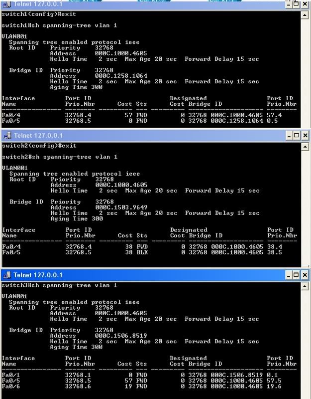

Thanks for the reply,
I have a simulation setup and I gave it a try.
I'm assuming it would show under the root id, correct? I'm a bit confused bc theres two sections (root and bridge id)
I have an image of the output for the three switches
http://i3.photobucket.com/albums/y92/ddzc/VLANROOTBRIDGE.jpg
It looks like the 000C.1000.4605 is the root bridge or am I wrong? Problem is, I wouldn't know which switch it is or can you tell with emulated switches?
Thanks
Yes, Under the root ID you see details of root bridge.
Bridge ID, is the details of the current switch. If the Switch is the root, then both the root ID and Bridge ID fields are same.
also in your setup, the switch with MAC 000C.1000.4605 is the root.
