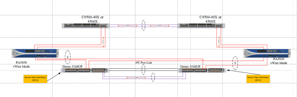

I have two Nexus 5000's in vPC mode. They have northbound vPCs to Cat9500. The Nexus switches share a vPC peer-link and also share a a Layer 3 link.
I have two Palo Altos running in vWire mode between the Nexus switches and Cat9500s.
So here's the question...
Can I run EIGRP between the Nexus switches and the Cat9500s, while making sure the routing and adjacency does not form over the vPC Peer-Link?

Nexus 5K works in a different way. Your topology matches with one of the deployments of the first link, without the layer 3 link between them (check also the NX-OS version):
https://www.cisco.com/c/en/us/td/docs/switches/datacenter/nexus5600/sw/interfaces/7x/b_5600_Interfaces_Config_Guide_Release_7x/config_vpc.html#concept_411EC30FA71841A49905F2E5C133799D
https://adamraffe.com/2013/03/08/l3-over-vpc-nexus-7000-vs-5000/
So then peering between the two peers does not need to exist? Is that what that document is saying? I always thought it did for some reason.
Also looks like this may pose some challenges with multicast traffic. I am running inforacast servers behind my nexus switches so multicast is a must. What are the challanges with multicast when it comes to vPC?
According to the documentation, L3 link between Nexus 5K switches is not needed (but again, check the NX-OS version)

Due to the risks of running routing over vPC, I think I will just run Layer 3 port-channels from each N5k to each C9k and run routing on those, then I can use ECMP with EIGRP and let routing decide what it wants to do. Anyone see any issues with that? I really think vPC should be kept at a layer 2 level.
That's fine.
The only question is, do the Nexus switches need a L3 link between to peer EIGRP with each other?
Yes sir.
