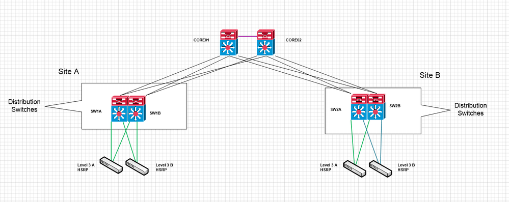

Hello Guys
Need your help putting this to work.
Currently i have 3 location with the same specific vender networks with router-Firewall(DMZ)-L3(whith HSRP)-L2Switches
The board decided that we should have all locations connected together. They hire an external company to do the job. So what they did was install redundant firewall-Core-switches-Distribution-switches, so far so good. The problem now is the integration we the current vendor networks we already have. The external company says that they did what they were hired to do, the specific vendor was not consulted so it will not give support. So now is about the internal IT team to solve this problem.
Can L3 Switches with HSRP work connected to the distribution switches configured in Stack, has per the attached image. If yes how?
Any inputs are welcome.
Regards
Jaderson Pessoa
Hello @JIMYSPEED ,
are you looking for something like it?
