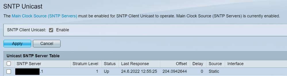

Time is set to from NTP server:
Settings:
