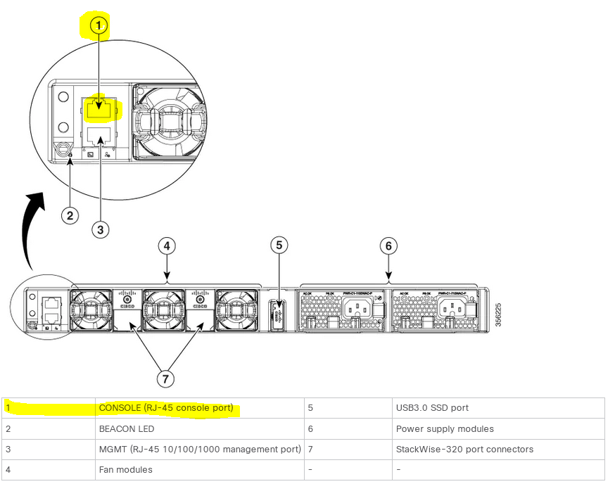

balaji.bandi
Cat 9300 bit confused on the back - it has console and mgmt connection make sure you connected the right port
here is the console serial settings - change the COM and SPEED ( default 9600 should work)
BB
