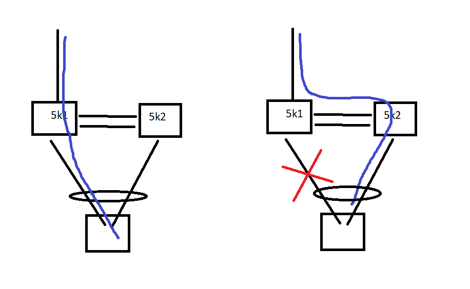

Hi @romanroma
The failure scenario where unicast traffic is being forwarded over the peer-link, is when one link from the vPC port-channel goes down, and unicast traffic is received on the peer where the link is down. Here is a graphical view of the scenario:
left - working scenario ; right - failure scenario
Cheers,
Sergiu
@Sergiu.Daniluk
That is very helpful thank you...
