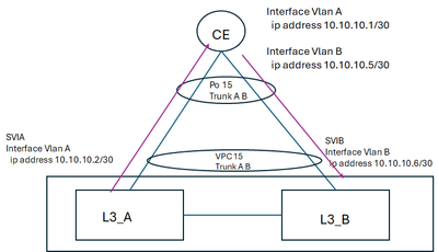

I have designed a topology for a migration, but after trying it on eve-ng I found a problem. The topology is the one in figure:

First problem: Type 2 inconsistency, since SVI A is configured only in device A and SVI B in device B. I read that this problem can be solved by removing the vlan form the trunk. I done it, and forcing the SVI to be up (no autostate).
The real problem is that if I try a Ping from dev A to Router SVI A, the response is forwarded by the CE (due to the hashing) to the link connected to device B. So the ping is lost.
Even if I leave the 2 VLANs (A and B) in the trunk, the problem remains I think (need to check).
Is there a way to solve this situation, leaving the topology connection as it is? I cannot for example, remove the po15 from router and configure 2 different links to the N9l devices

Why you use PO in CE config as trunk carry two vlan??
Config one link as trunk (or access port) to each NSK this link have only one vlan whcih connect to one NSK.
No need to config PO
MHM
Hi @MHM Cisco World sorry for the delay, unfortunately I cannot remove the PO, so I had to resolve the problem. I finally solved it with the command: peer-gateway exclude vlan SVIA, SVIB on both the peer devices. This removes G flag on the SVI MAC ADDRESS and the packet traverses the peer-link.
