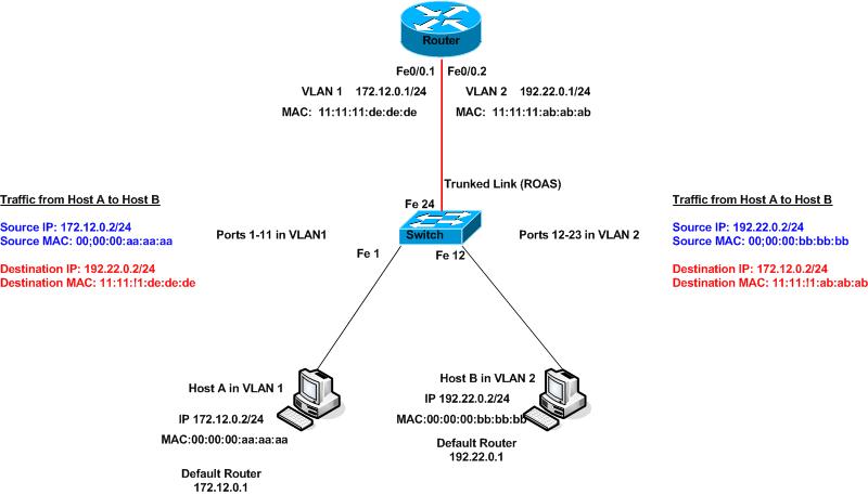

Topology: See Attached diagram
Host A wishes to communicate with Host B, which is on a different subnet. Say user on Host A typed ftp 192.22.0.2.
The TCP/IP stack on Host A will see that this host is on a different subnet, so Host A will check if a default route is configured. If no default router is configured, the FTP session will show a "host not found" type of message. If a default router is configured, Host A will send out an ARP request, seeking the MAC address on the default router.
The switch, when it receives this ARP broadcast, will note the MAC address which sent the broadcast and the port it arrived on and will enter this information into it's CAM table. The switch will then check its CAM table to see if it has an entry for the destination MAC address. If the switch has an entry for the default router it will pass the unicast the ARP request to the router. If the switch does not already have an entry for the router in its CAM table, the switch will broadcast this ARP out all ports in the same VLAN as Host A, except the port the request was received on.
The default router will respond to the ARP request and the switch will create the entry in the CAM table, noting the routers MAC address and the port to which it is attached.
The ARP response from the Router will be unicast back out the port Host A is attached to.
From this point on, traffic from Host A to Host B will leave Host A with the source IP and MAC of Host A, the destination IP address of Host B BUT the destination MAC address of the default router.
The switch will SWITCH the frames between the port the frames were received on (where Host A is connected) to the port where the Router is attached.
The Router will route the packet towards Host B by sending the packet down the trunked link towards the switch. The Packet will now have the source IP address of Host A, the source MAC address of the routers exit interface and the destination IP and MAC address of Host B.
When the switch receives this packet, it will check its CAM table to see if it has an entry for the MAC Address from which the packet came and the port on which it arrived. If it does not it will create the entry.
The switch will then check its CAM table again to see if it has an entry for the destination MAC address. If it does it will SWITCH the frame to the appropriate interface. If no entry exists, it will flood the first packet out of all ports in the VLAN to which the frame belongs, except the port the frame arrived on. Host B will respond to this broadcast and the switch will enter the MAC address of Host B and the port to which it is attached into its CAM table.
From this point on, all traffic destined for Host B will be switches to the port to which Host B is attached.
Traffic from Host B destined for Host A will leave Host B with the Source IP and MAC address of Host B, the Destination IP address of Host A BUT the destination MAC address of Host B's default router.

Hi all
****** Corrections to my previous post******
First as Scott rightly points out, in my previous post I used the term "Broadcast" where I should have used the term "Flood".
In my previous post I wrote
"If the switch does not already have an entry for the router in its CAM table, the switch will BROADCAST this ARP out all ports in the same VLAN as Host A, except the port the request was received on. "
When I should have written
"If the switch does not already have an entry for the router in its CAM table, the switch will FLOOD this ARP out all ports in the same VLAN as Host A, except the port the request was received on."
Secondly
In my previous post I used the term "unicast" when I should have used the term "Switched".
"The ARP response from the Router will be UNICAST back out the port Host A is attached to. "
"The ARP response from the Router will be SWITCHED back out the port Host A is attached to. "
Finally, Scott wrote that I mentioned ARP and as this is a layer 3 protocol for discovering and mapping IP addresses to MAC addresses, a basic layer 2 switch would not know ARP.
I mentioned that Host A would initially send an ARP request for the MAC address of the default router. I don't believe I mentioned that the Switch would send an ARP and even after reading my initial post again I can not see how this is implied. However I apologise if from reading my initial post, I conveyed that a switch would initiate an ARP request, as this, as Scott rightly points out would not be possible on a switch operating at layer 2.
Best Regards,
Michael
