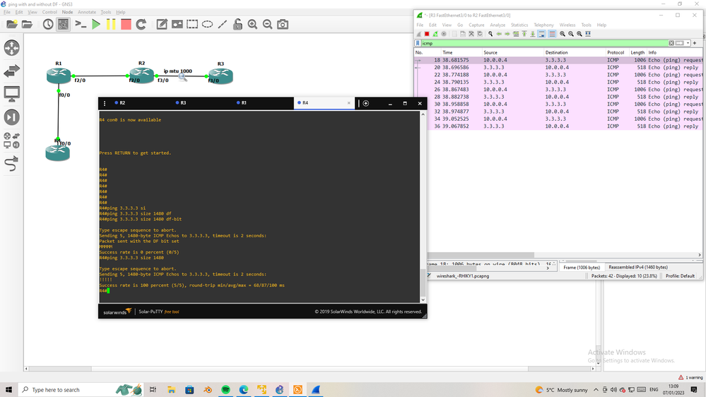

I run lab, between R2 and R3 I config the mtu 1000 and keep other interface with it default MTU 1500.
with df set the icmp is failed
Fragmentation means packets get divided right? Like 1500 would be sent as 1000 + 500 to destination?
and if we set df-bit then packet would be sent as whole i.e. 1500 till destination,Right?
Yes correct
"Fragmentation means packets get divided right? Like 1500 would be sent as 1000 + 500 to destination?"
If a transit link's MTU was 1000, and a 1500 byte packet wants to cross it, then yes, w/o DF set, a 1500 byte packet would be fragmented into 1000 + 500.
. . . to destination?"
Well, that depends. Perhaps there as another later link with a MTU of 400.  The 1000 + 500 would then be further fragmented to 400 + 400 + 200 + 400 + 100.  Then assuming no further fragmentation is need, the latter is what the destination will receive.
If, though, the 400 MTU was encountered before the 1000 MTU link (like going in the reverse direction), again starting with 1500, the initial fragmentation would be 400 + 400 + 400 + 300, which would not need fragmentation when it got to the 1000 MTU.  The latter is what the destination would receive.  (Do note how different MTU limits fragment "differently" depending on the sequence the lower MTUs are encountered.)
". . . and if we set df-bit then packet would be sent as whole i.e. 1500 till destination,Right?"
Yes, again, if fragmentation is NOT needed along the way.
