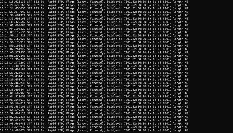

Below is simulated in CML 2.4.1. Why STP packets are going every 9-10 seconds?
Thanks in advance

But VM receives those packets in average every 16-17 seconds [2] (tcpdump)
If there is a delay in packet transfer because of some simulation issues, I believe still tcpdump should receive every 10 seconds.
Interestingly, when changed hello time to 1 second, tcpdump receiving BPDU in average every two seconds [3].

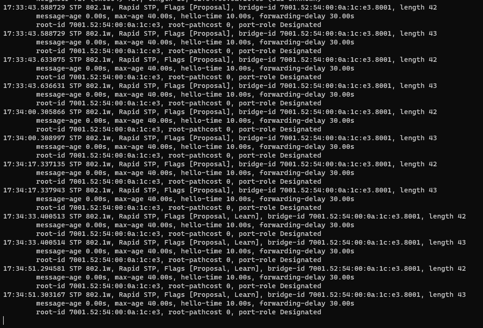

there is delay, and we can not predict it - Yes I can predict it: packet arrives ALWAYS to VM after 3-4 seconds when hello timer is set to 2 seconds. packet arrives ALWAYS after 16-18 seconds when hello timer is set to 10 seconds.
Hello timer set to 2 seconds. VM tcpdump:
Hello timer set to 10 seconds. VM tcpdump:

Will all respect Sir - the packets are predictably arriving within 30 milliseconds (0.003 seconds) as expected when in normal operation as I mentioned (screenshot below). Other forum user said also said that there should be no random delays in arrival of RSTP.
