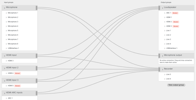

If you check the Audio Console on the Codec Pro, is the audio being correctly sent to the output you have connected?
Sample Audio ConsoleSample Audio Console
