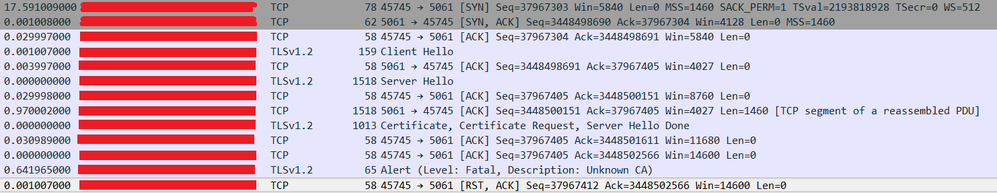

Appears to be a certificate issue - we are getting a TLS Fatal Alert 48 - Unknown CA from the carrier when we are the server (calls/sip connection is inbound w/ respect to our CUBE).

Below is screenshot of packet capture when our CUBE is acting as the server:
Ok. From the snippet, I see "Server Hello", CUBE sending it's digital certificate and then requesting the certificate of the client which would be your ITSP. This is correct. The client cert request is optional but it is not illegal.
Who is sending the "Fatal Error" ? I can't see the IP addresses in the snippet.

The fatal error is coming from the carrier.
