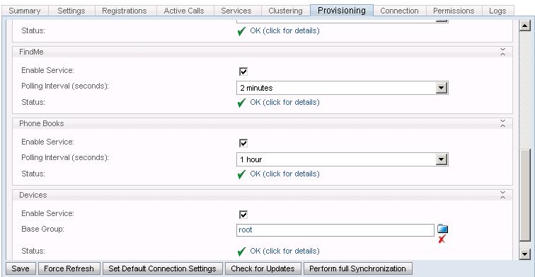

Can someone please suggest why this could be happenning? TMS is complaining of a critical error whereby it cannot import phonebook data from TMS. I can confirm that the password is correct, the provisiong tab on the VCS shows 4 green ticks, the TMS agent service has been restarted about 20 times, health checks ran, cleanups ran but yet the phonebook is blank. This is a new installation of Jabber (lastest software on VCS, TMS & Jabber) and the Jabber clients are able to log in, call the MCU and other Jabber etc, the only issue does appear to be this phonebook conection, it has me stumped :-)

07-10-2012 07:49 PM
Thanks for this Rafal. Unfortuanatley the customer did not want to enable "Ole Automation" due to security issues. !!!
Double checked the tmspe account admin rights and that is ok.
We tried to do another install of this but continue to get this below :
