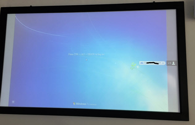

I've never seen this before.  I was hoping someone knew how to make it disappear, we're using the 10 Inch panel remote.
The full phone number is appearing next to +1 Person.   The +1 can stay but I would like the phone number to go away.
This is  an SX80 running TC7.3.4 which has dialed a SIP address.   The blurred  out part is the number of our teleconference provider which the SIP entry forwards to.
I am not local to the unit, it's in the UK and i'm in the US.
Thank you,
Jamie
Teck Chye Tang
Can you confirm again if it is TC7.3.4?   We used to have this is older software version but it should have already been fixed in TC7.3.4.  You should only see the +1 icon.
