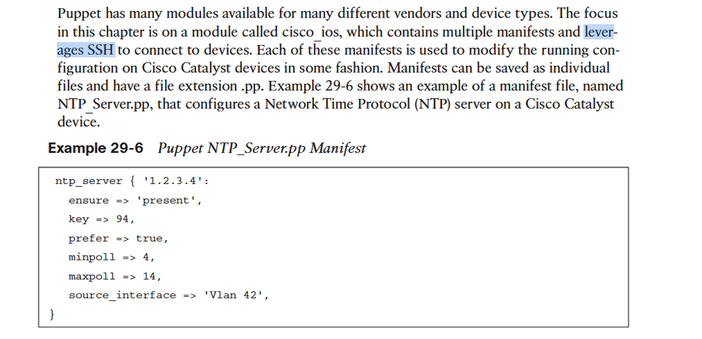

I am studying for my ENCOR exam so I really only need to know the basics regarding orchestration tools (ansible, puppet, chef, saltstack). My question is, what exactly do Puppet agents use to communicate with the Puppet Master and pull the configuration from it? The official website says that it can use HTTPs over port 8140 but my book also mentions this:
So can Puppet also use SSH or what exactly does it leverage for the communication?

You are right yes. Puppet agents communicate with the puppet master on https and the puppet master, though can use various protocols, including ssh (which i think the book is referring too), to apply the desired state to the end devices it might be managing, this therefore allow options depending on the device type and the puppet module being used.

The cisco_ios module should be installed on a proxy agent that manages Cisco IOS & IOS-XE devices. This way you don't have to run the agent on the devices themselves. The proxy agent uses SSH to manage the devices. See the Github repo for the module for more information: https://github.com/puppetlabs/cisco_ios
