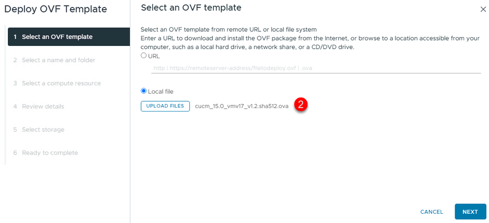

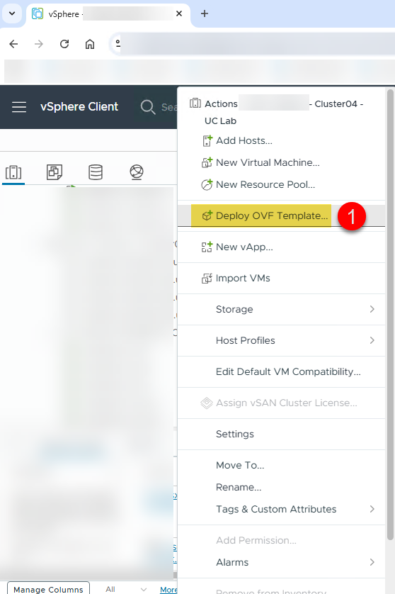

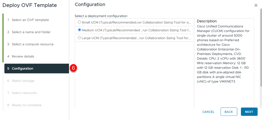

Time never allowed me to get back to you on this yesterday. This is how it looks when I create a new VM based on the OVA.
Snag_1acd63a.pngSnag_1acfe92.pngSnag_1b2613b.pngSnag_1ae9d0f.pngSnag_1aeac22.pngSnag_1aebcfb.pngSnag_1aed1bb.pngSnag_1aee41b.pngSnag_1aef9b6.png
As you can tell it looks very different from what you shared. What type of ESXi are you using? I've added the same OVA that I used for reference.
