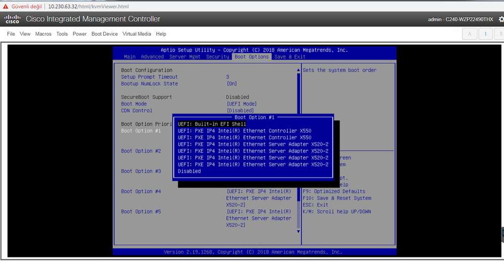

Mega raid option does not appear when the server comes to the bios screen, I see the Megar aid PCI card when I look at the bios but I can not do in the configuration because all setting is disable. There are three from this server and they all have the same status

Bios_Boot_Screen.PNGBios_Advanced.PNGLOm_PCI.PNGConf1.PNGConf2.PNGBios_boot.PNGVirtula_Drive_Disable.PNG
Raid card configuration does not appear on the bios screen. The ctrl + m combination does not work. I am trying to create a raid configuration on the server  but I cannot access the raid controller configuration screen.

Now the cimc settings are like in the image files. but there is still nothing working.

As per your features listed and screenshots, your C240M5 server is in UEFI mode and it's loaded with "Cisco 12G Modular SAS HBA (max 16 drives)" card. And this card doesn't support any RAID configuration, only pass-through mode.
Please refer C240M5 spec **bleep** for more info(https://www.cisco.com/c/dam/en/us/products/collateral/servers-unified-computing/ucs-c-series-rack-servers/c240m5-lff-specsheet.pdf)
