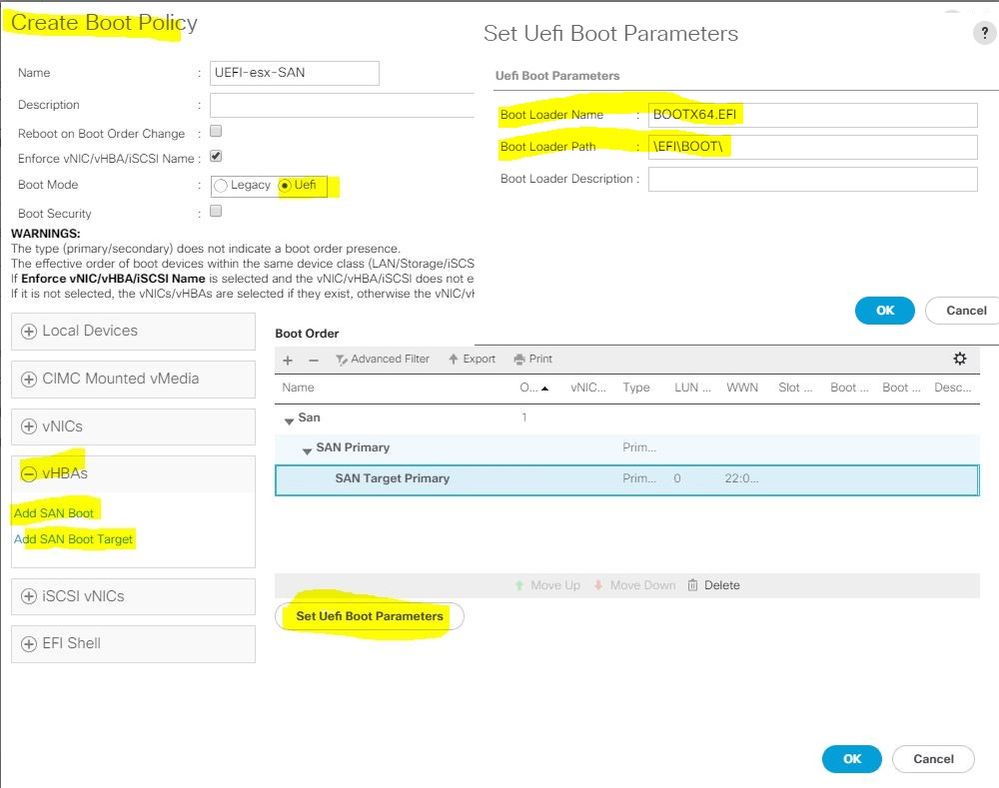

Looking for a little guidance on getting ESXi 6.7 to SAN boot in UEFI mode. We are migrating to a new SAN storage and in the process working on vSphere upgrades. I'm able to boot in Legacy Boot Mode from the new SAN but when trying to use UEFI Boot mode I can install ESXi but once that completes it reboots and enters the BIOS screen of the B200 M3 blade instead of booting ESXi. Are there any other requirements for UEFI Boot Mode?

If you are doing this for a number of blades, then create /modify your boot from san boot policy to include Uefi Boot Parameters:

I'm not seeing fs0 in the EFI shell only blk0 and blk1. I have my boot policy setup like your screenshot above. Thanks for all your help. I'm obviously missing something.

I was able to get this to work with by specifying a Local LUN/Disk in the boot order (UCS Central). This is with UEFI and Secure Boot enabled. Input the boot loader file and paths like shown in the screenshot.
Running some of those commands in the shell had some output as if UEFI sees SAN disks as local.
