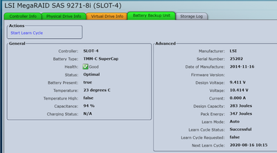

@Kirk J   Hi kirk, Thanks for your response,
 I have made a "start learning cycle" under BBU and it completed successfully.(screenshot). However, the Cache degraded error is still there.
So where could be the issue?  The issue could be the Transportable Memory Module (TMM) itself and not BBU?   As per my understanding, the TMM itself is the Cache Memory?

Hi @Kirk J,  Thanks for your reply.
Ran the 'learning' cycle again and battery relearn completed successfully, but the Cache Degraded Error is still there.
So where could be the issue? Could be the Transportable Memory Module (TMM) itself and not the BBU/Supercap?  I hope the Transportable Memory Module (TMM) itself is the Cache Memory?
From the  Spec Sheet, the statement   "The 9271CV-8i RAID controller card includes a 1 GB Transportable Memory Module (TMM) and a chassis-mounted (remote) supercapacitor (supercapacitor not available on the 9271-8i) for data cache power backup "

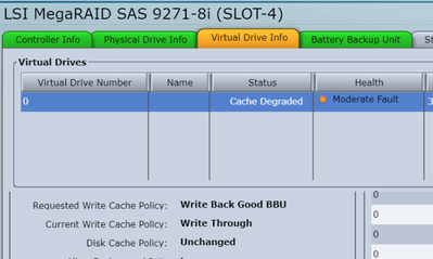

@Kirk J   :  Today morning the Status Changed back to Normal. Same thing happened last week also. WB changes to WT and sometimes returns back to WB.
BBU changing from WT to WB back and forthBBU changing from WT to WB back and forth
It will do that normally when the learning cycle is running.
But the learning cycle should only run once a month, so there must be something about the SuperCap that is flapping.
It will take reviewing a tech support from the CIMC, and specifically the raid controller tty logs that get pulled that will shed light on what is really happening.
Kirk...
