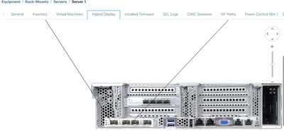

Wait. I just saw the UCSM screen shot showing MLOM VIC port 1 and port 3 being connected on the server side but also a second PCIe Cisco VIC above.
Re-cable the second VIC port1 to port3 and then re-ack the server. Then the UCS Service Profile should associate.
If you don't have cables, then physically remove the second PCIe VIC.
ALL Cisco VICs MUST be connected to BOTH Fabric Interconnects. This is a VERY common mistake.
