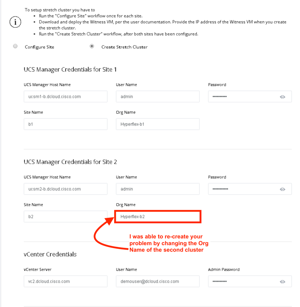

Hi @mumbai.support ,
I hacked together a stretch cluster install on dCloud this morning to see if I could understand your problem better, and I was able to re-create your problem by changing the Org Name of the second cluster.
So I suggest you double check to see that the Org Name that you have entered on this page matches what you see in UCS Manager for the second site
