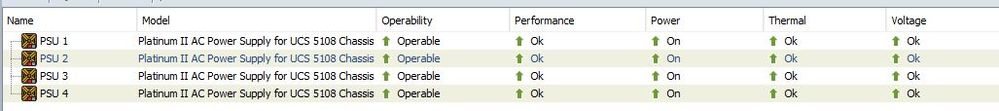

i have UCS 5108 AC2
with two Chassis
chassis 1 have 3 Servers
chassis 2 have 5 Servers
we had a stranger activity as all the  VM in All 5 server in chassis 2 cant connect to each other
after that we got power error on chassis 2 as below  and all the PSU is up and running
the power policy is N+1
and all 4 PSU is connected to 4 different power source .

Those events should't be related to VM connectivity issue. What is the UCSM code? There are many bugs related to redundancy failure messages on chassis, however all PSUs will be working fine.

i know that those event realted to power but what cause the VM connectivity issue
as there is event in same time made the I/o to change from right to left and made some changes
That's definitely a co-incident, but these shouldn't be related. BTW what hypervisor you are running? What is the even on OS end?

do u mean the below
and do u think that its okey to connect the 4PSU to different power source
<faultInst
ack="no"
cause="power-problem"
changeSet=""
code="F0408"
created="2018-10-12T15:51:24"
descr="Power state on chassis 2 is redundancy-failed"
dn="sys/chassis-2/fault-F0408"
highestSeverity="major"
id="4834781"
lastTransition="2018-10-12T15:51:24"
lc=""
occur="1"
origSeverity="major"
prevSeverity="major"
rule="equipment-chassis-power-problem"
severity="major"
status="created"
tags="server"
type="environmental">
</faultInst>
n+1
tell me if i use Grid policy does that mean that i restrict with only 2 power source or i can add more .
no restriction on number of PDUs, you may add multiple power source.
