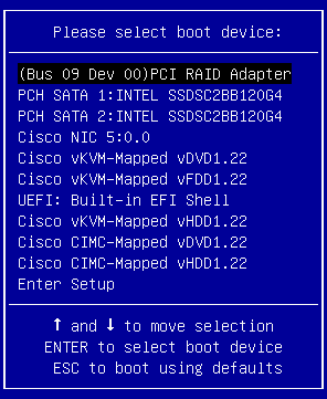

I haven't put my hands on the box, but I'm pretty sure they're connected to the PCH. Hopefully these images will tell the story...
The pile of disks listed by the RAID controller are all storage devices, and the PCH SATA devices listed on the boot menu are the ones it's supposed to be using for the OS.

Thanks, Kirk.
The driver issue was solved by using the CentOS7-Everything iso instead of the standard one. After that was settled, I still had to enable the SATA raid in BIOS. I believe that we still need the Megaraid SR driver because, in addition to the two SD's, we also have some 24 storage drives installed.
