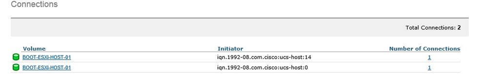

Although I can't ping the iSCSI vNICs, the Nimble web console seems to think they're connected:
It's just odd that the IP addresses aren't pingable from either the Nimble or the Nexus switches - perhaps they don't respond to ICMP?
