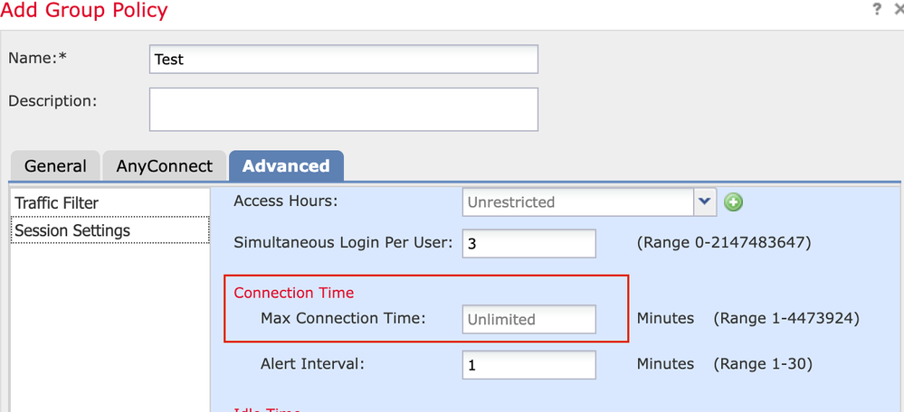

When a Remote User connects to FTD Headend , by default  " Maximum connection timeout " is set to unlimited . To avoid Users logged in as long as they wanted , you can configure " Maximum connection timeout " to a certain value and when max connect timeout threshold reaches post vpn connection , the session will be disconnected and user will have to reauthenticate . This setting can be configured/modified on FMC under the " group-policy " that is being used with the connection profile . You can also configure Alert-time interval ( that will alert user , x min time before the max connection timeout ) that could potentially help user wind up or save his work before VPN gets disconnected .
Sharing Screenshot for your reference ( Below )

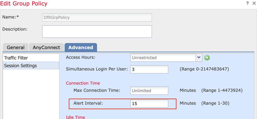

Thanks for the great information. Just curious, if I set a value in the Maximum Connect time is there a way to display a banner say about about 15 minutes before they are disconnected.
Sorry just saw the answer to this
@ethutchinson yes you can do that . You can configure Alert Interval in Group-Policy ( see below SS ) to 15 minutes ( max is 30 min ) that will alert user about vpn session time expiring before they are disconnected . It would not be presented as a banner but a toast notification to the user . This toast notification is not seen in Anyconnect 4.10.x but Cisco Secure Client ( formerly Anyconnect ) 5.0.x onwards .
This is how a toast notification / pop will look like
